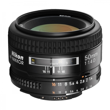

Obiective fixe testate comparativ: Nikon 50 mm f/1,8 AF-D vs 50 mm f/1,4 AF-D Nikon-AF-Nikkor-50mm-f-1-4D-3886
Nikon 50 mm f/1,4 AF-D, 1399 lei în oferta F64
